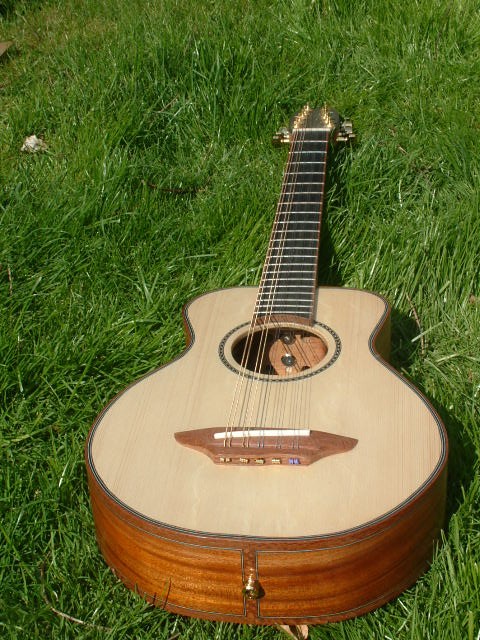

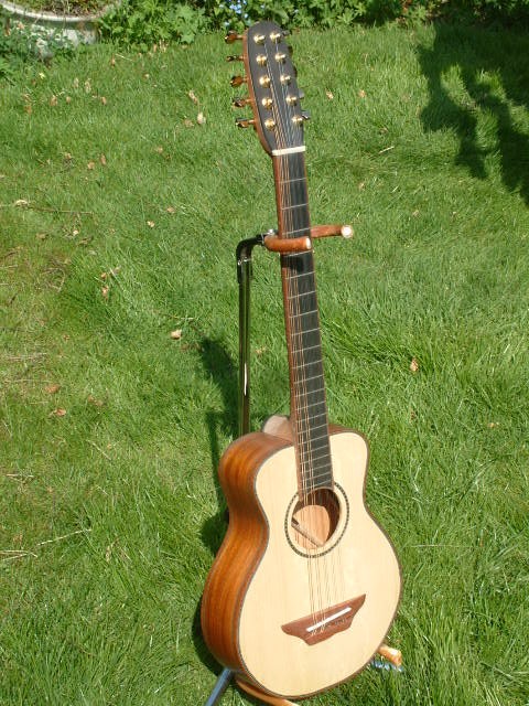

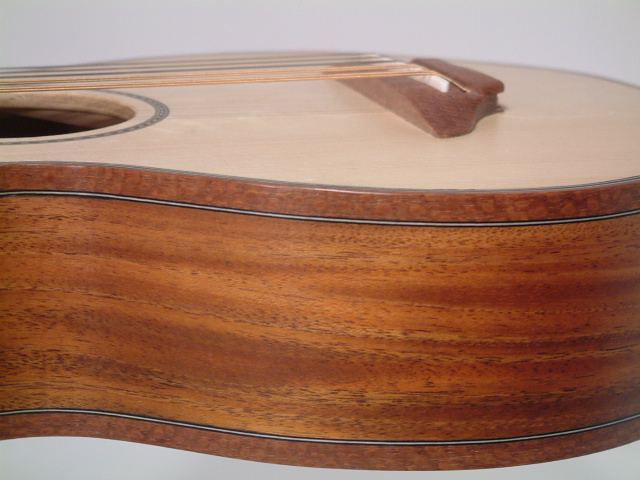

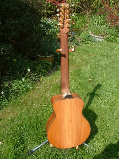

This is the second in my Celtic Festival Series of instruments - Imbolc. It's a short scale guitar-cittern in Euro spruce/Cuban Mahogany, with Rupola lacewood bindings and bridge, ebony headstock veneer, and mimi Gotoh tuners. The neck is adjustable and is mahogany/lacewood/mahogany with a London Plane (Sycamore to you) heel. Finish is light handrubbed nitro on the body and as of now the neck is just bare wood.
Scale length is 605mm (23.8") and it has unison pairs in 0.011", 0.012", 0.016", 0.029"w and 0.039"w. There are as many cittern tunings as there are players but I use GDADE.
I bet you're all wondering what it sounds like. Well here's a sound clip of a work in progress. Imbolc

Great stuff Dave!
Made me want to snatch up a jug of cider and go roll in the grassy meadows with a fair maiden....then again that may have just been the oysters I had for entr'e.
None the less she looks and sounds marvellous, but is no less than what we have come to expect from your workshop, excellence.
Well Done, I'm off for that roll now

Nice Job Dave.
How did you get on with the hand wiped Nitro ?
Love the layout of the headstock, nice and sleek dispite having to get all those tuners in.

Happy rolling. Glad you liked the tune - I can see your folk roots by your name "larkim the morning"
Russell,
There are very few coats on there at present, I'm going to build them up over a number of weeks/months. Mine's a pretty basic technique - spray from a can and then rub back with 0000 wire wool. It gives the look and feel of the Lowden/McIlroy finish.

Very nice!
And what is prettier than Cuban Mahogany?
Gorgeous stuff eh?

Great job Dave, Euro/Cuban has got to be the Rolls Royce of wood combinations and with your build quality don't you just know it's gonna sing. I love the LP in the heel to add a little interest, and the subtle binding is a joy. I much prefer the 'guitar' body shape than the more traditional tear drop.
